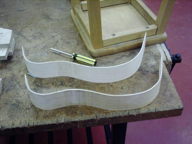

And here's some maple mandonaught sides.
I had to cut a set of sides from the back set to bend these as the guitar sides were banjaxed.

Maybe it's just distortion in the pictures, but those 'sides' look pretty thick. What thickness are you going to before bending? Average values tend to be ~2mm or .080 inches for most folks.

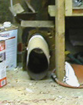

This is a bad picture of the 6 inch steal pipe that I found and crushed in a big vice to get various curved surfaces out of one pipe.
It is mounted on a big block of wood with a hole cut through so I could have a torch heat it up from the block side.
Lately though, I bought a short heating blanket and drape it over the same pipe to do my bending. I can still “feel” when the wood is ready to bend and I can control the heat much better with the blanket.
You may still want to use your small pipe for tight bends.

as to the thickness of the maple, bear in mind that these are mando and not guitar sides!!
they are 2mm thick

The last set of sides I bent on an iron were koa, and a bit on the thick side as well. One side ended up with a 'kink' like the mando side in your pic. I figured it would 'go away' once the linings were in and the body was sanded.
I've been looking at the darn thing for 25+ years now and still notice it!
